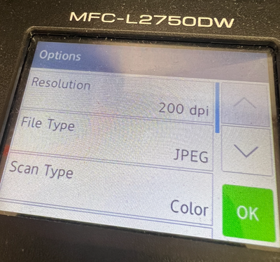

@yefimv wrote:
Hello,my photo 210x600 pixels how do i know the size of a pixel so i could know the real dimention?
suppose i set my flatbed scanner to 2000X2000 so i need to measure the scanning area of the flat bed and divide the length of the scanning window by the number of pixels?
The size of the bed is irrelevant.
Just set it to a specific DPI. (I've included a picture of my scanner settings below. Yours will be different, unless you have the same model as I have.) Really doesn't even matter what it is, just so long as you know what the number is- your drawing doesn't have a ton of precision built in to it. The only thing that matters is that you know how what the DPI setting is.
Then just divide the number of pixels on that side by the DPI, and that's the length in inches of that side of the picture.
Dimension the whole image, not the bit that you drew. You can figure that part out later, once you have the overall image set at the right size.
My scanner settings:
Using the 200 dpi you see there, your 210 x 600 would come out to be 1.05" x 3".
