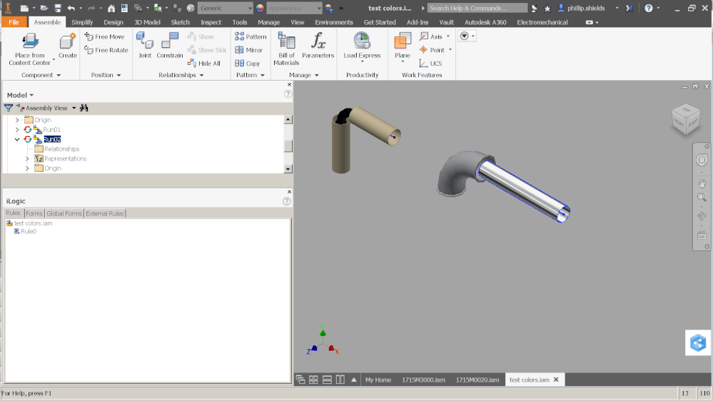

I'm having trouble changing the color of my tube runs using iLogic. I have an assembly, I've created a tube run within this assembly, and when I try to run the code below at the assembly level the code doesn't work. However, if I open the "Tube and Pipe Runs" file and put the same code in there it works. The problem is that the "Tube and Pipe Runs" file does not pass the overrides back up the the parent assembly file.
Component.Color("Run01") = "red"
Component.Color("Run02") = "green"

You will probably need to change you approach on this. T & P works with "Styles" to change the color of runs and keep them. You would need to have created the "Styles" for each color within your T & P Template File and then have your iLogic select the correct Style.

We have a lot of styles(about 25) and we have at least 8 different colors for each style. I was looking for something a little quicker than creating a style for each color. If this is the only option then so be it but I would like to program something. Maybe I can create a routine that creates the styles for me?

Curtis_Waguespack
@ phillip.shields
I know you were asking for another solution that SiloMan explained offline, but I'll add this iLogic just in case it helps others in the future.
( Note we just finished this up on Friday, so it might not be fully rolled out internally yet.)
