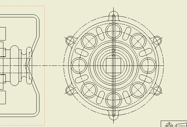

You can see in the Finished Drawing (assignment drawing) there are no curves. But in .idw file there are curves.  How to get rid of this?

you can click on those items in the idw and turn off the visibility ... however your view is CORRECT ..it's showing the true projected view with the bends
you can see I turned off the bottom ones ... with a click of the mouse

Turn off visibility of Tangen Edges
or
right click and hide.

Your Sketch18 has incorrect dimension and is not fully constrained.
Also, Sketches 6, 8, 12, 14 are not fully defined.  You have been instructed here to stop at any time you do not have a fully constrained sketch and ask questions here about how to correct the situation.
With correct dimension - the Sweep does not intersect the square cut.
Message 5 of 18
Thanks for identifying the error. Shown curves in the .idw file also vanished with the dimension correction in Sketch 18.
