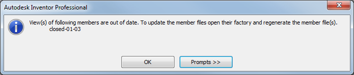

Hi
I have created an  iassembly in autodesk inventor 2014 And it's drawing but whenever I modify the assembly Drawing is getting out of date.
drawing shows all views are out of date because of this I have to create Drawing again and again I have updated all views by Global update and normal update but still it's not getting updated Can you give me solution on this

-niels-
Welcome to the forum!
I'm not too familiar with iassemblies, but i'm wondering; are you generating the files again after you make your changes?
Also, on the drawing, make sure the "associative" checkbox is checked.

Niels is right, you need to update members as per my error here:
There are work-arounds but that's just being lazy updating from the drawing instead of doing it correctly and I might add that these don't always work and you still need to do it in the model.
(work arounds that force update would be to switch back and forward the member in the model state of the view, or to suppress/unsuppress the view).
What you need to understand is that Inventor will generate separate files for each member so these need regenerating from time to time (when major changes occur).

Whenever I modify an iassembly I always do a "rebuild all" then generate the members again..
Its just habit now.. rebuild all, generate, save then go to the drawing

Great help , tried your suggestion now every thing fixed.
issue was i need to make the assembly configuration on inventer so i opt iAssembly in inventor , then i achived the variable dimension on 3D assembly but when i am trying to get those on 2D dwg i was getting error (image attached) after implementing your suggestion issue is fixed.
