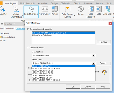

Mold Design Environment
Old environment - Select Material would bring up comprehensive list of plastic materials...
See third tool from left in image.  How soon they forget.  Not me, hastened my retirement decision.
@yahyayaksiz
Most of the analysis tools were moved out of Mold Design Environment over to Fusion 360 because the tools were not written for 64-bit code.
No longer able to specify plastic material in Inventor (Mold Design).  Have to go over into Fusion 360.
