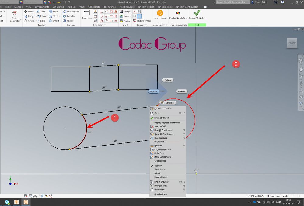

Hi @cyberider,
Like @torbjorn said it's an annoying bug.
You have created those rectangles and Circles within a Sketch Block.
You connected it with lines.
At this moment Inventor doesn't see a closed loop between the lines and the sketch blocks.
  1. Or you connect the end points with a arc (For the circles).
  2. Or explode the sketch block and Split the circle. (Than it isn't a sketch Block anymore)

Hi @cyberider,
