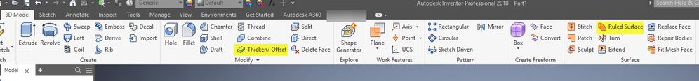

for Example : Ruled Surface, Thicken/Offset
Message 4 of 8
Mark.Lancaster
@Anonymous
What version of Inventor are you using?
You are not seeing this in Inventor 2016-2018 while part mode.
Mark Lancaster
Message 5 of 8
I found Thicken/Offset Under Combine but , I can't Find Ruled Surface in The Surface Panel . Also When Trying To make A user Panel i find A lot of commands not represented in the ribbon . I use inventor 2015 32 bit (student Version)

As far as I know Ruled Surface was a new feature in Inventor 2016 and doesn't exist in Inventor 2015.
Also if you right mouse click on the drop down icon and select ungroup like this, then the function is added to the Main Ribbon tab.
