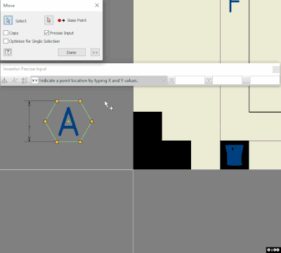

I have to admit, I don't have an idea how to use precise input with move tool in sketch enviroment properly. I think I have tired all possible combinations, but it doesn't work for me.
I want to move selection (base point, to be exact) to X=0, Y=0 (absolute coordinates - in ACAD _move #0,0).
  1. Ok, coordinates filled-in. Just hit done and it has to work. Nope.
    Just hitting done.Just hitting done.
  2. What about hitting enter after filling-in coordinates?
    Trying to confirm position by ENTER.Trying to confirm position by ENTER.
  3. Maybe context (right-click) menu?
    Trying to confirm position by context menu (righ-click).Trying to confirm position by context menu (righ-click).
  4. UGH... Maybe input with delta will be working. Just trying...
    Maybe delta works...Maybe delta works...
  5. Hey it's locked on filled positon. What about left-click to confirm placement? Error, because constraints. But it could be moved freely! (Yes, text is constrained to polygon centre, but it is not excuse!)Trying to place it by left-click when coordinates are filled-in. Error, byt it could be moved freely.Trying to place it by left-click when coordinates are filled-in. Error, byt it could be moved freely.
Ok, I'm done. Please help!

Hi Pavel,
Your English is perfect. Don't worry about it! The workflow to relocate a sketch precisely can be cumbersome in Inventor (compared to AutoCAD). It is because Inventor sketch is dimension and constraint based. The absolute location may not matter. It is all about relative location. Could you tell me why dimensions and constraints are not helpful in 2D sketch?
Another workflow you may consider is to create sketch blocks. In sketch environment, right-click on the ribbon -> Show Panels -> check Layout. You can create sketch blocks for reusing purpose. The entire block moves like a rigid body like Block Reference in AutoCAD.

At first, thanks to reply. I try to explain it more:
TL;DR: I need some reliable way how to place point of the unconstrained sketch to origin. (To place using Move tool and projected origin seems not to be reliable). [end of TL;DR]
In the images above is sketch symbol and I wanted it in 0,0 because more beacause my OCD then something else.
BUT I'd like to use the precious positioning when placing pasted DWG data into sketch. It's really CTRL+C; CTRL+V, because link to DWG is unwanted. These DWG data are some (more or less) raw sketch created from old (often damaged) paper drawing. I create some "skeleton" sketch based on this data.
Problem is when DWG is not placed precisely. There isn't any dimension only some constraints (coincident) in the pasted data and when I start to add them it moves with affected geometry and changes round dimensions in not-yet-constrained pasted data for me (round dimension is very often dimension based on dimension written in old drawing - it's more relevant then other)

I tried it by placing data, use Move tool and select point on Data, then select the origin, BUT sometime it places it only very close to origin. (And then original Ø500 becomes Ø500,5 - for me it's sign that this dimension is guessed an could be slightly changed. This initially small error could make long chain and get bigger and bigger in every step.)

If possible, please share an example that exhibits the exact issue. Precise Input is available when you create new sketch geometry or Move the sketch. You can enter the absolute values or delta values. Either should work.

I ran into the same problem as you. the Move/Copy feature is indeed really frustrating and useless.
I solve the problem by creating a rectangular pattern. See picture.
