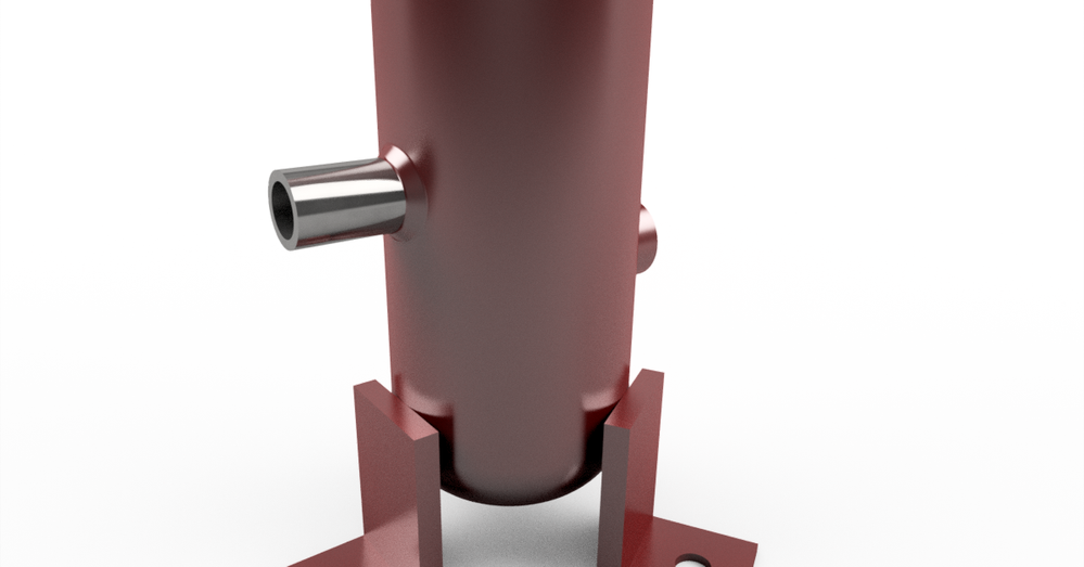

The image in the IBL is reflected on the parts causing an image overlay that is not always desired. See the two screenshots below, the one with a greyish hue over the red is with IBL lighting in Inventor studio, The other one with well saturated red color is in assembly environment with 'Two Lights' lighting.
So it seems, in studio,  the grey wall of the IBL image is overlayed on the red colored part.
All the lighting in Inventor studio seems to be IBL based, how can I have non IBL lighting in Studio?
Thanks in advance
Greyish hue caused by Studio IBLGreyish hue caused by Studio IBLWell saturated colors if no IBL is usedWell saturated colors if no IBL is used
The grey wall of the IBL image is reflected by the red coloured part.
Try reducing the reflectivity of the red coloured part (in Appearance settings). Reduce glossiness also...
As far as I know, it is not possible to use non IBL lighting in Studio.

Mark.Lancaster
@Amit262
Inventor studio has been around for many years and hasn't really changed.  Inventor 2016 is when IBL lighting was introduced.
If you only need a rendering (no animation), I would actually recommend that you enable view realistic and ray tracing and not use Inventor studio for rendering an image.

Are you using one of the default Studio lighting styles?

@Lewis.Young
Yes, I am using Grid Light

One thing i found out early on is that the "Photo Booth" lighting style seems to look a bit better.
This is a 200 iteration render using Grid Light:
And here's a 200 iteration render using Photo Booth:
Although these are just quick renders, i have produced some really realistic pictures using Studio, so i wouldn't give up on it just yet aha.
Try changing the lighting to Photo Booth and have a play with the settings, let us know how it goes! 🙂
