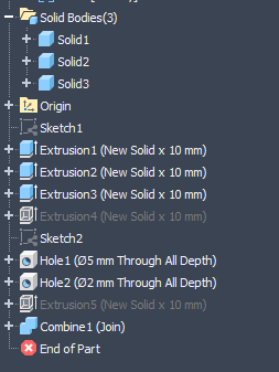

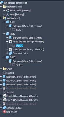

jnowel
here is a sample one.
if you try to edit anything above Combine1, say Sketch2, then the SolidBodies Tree will collapse.
I kinda understand why as at Sketch2, there exists Solid1, Solid2, Solid3, Solid4 and Solid5.
But after exiting, the Combine1 feature results to only Solid1, Solid2, and Solid3.
This requires the SolidBodies Tree to refresh/update.
Move the EndOfPart above the Combine1 then this "auto-collapsing" of tree will stop.
You can also expand the SolidBodies Tree, then move the EndOfPart again after Combine1
Then the  SolidBody Tree will "auto collapse again" upon activation of Combine1
This behavior will also exhibit with other feature commands like Bend or Split Solid.
