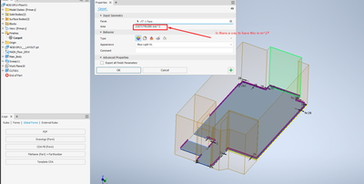

I am adding a finish to an area called "Carpet" and it gives me are in mm^2. I need it to be in m^2.
Is there a way to set it without changing my length units to m too?

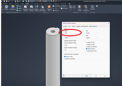

Go to Tools tab in the part or assembly. Then click on document settings
After that go to Units and change the length unit from mm to m

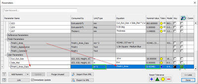

Here's an workaround (not so good, but that's what we have)
Copy the Finish area as a "copy to user parameter"
Change the units to m^2
link both parameters
set to export (to be able in drawings, part lists etc)
