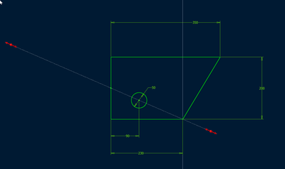

I've had occasions in the past where I've used construction lines in a sketch for some valid reason (I can't think of one off hand but I remember thinking about this before - it's really annoying me that I can't come up with a valid example). In these cases, there is no actual need to define, say the length of the construction line. It's just there for whatever reason I wanted it.
For example, in this (entirely made up just for the purpose of this discussion) sketch, I've decided I need my hole to be on a line defined by two points on the sketch so I've used a construction line.
 - Does it matter that my end points can float?
 - Should I add an extra dimension to define the line fully?
(yes, I'm aware that I could just draw the line so the ends are coincident with the outline in this case - this is just an illustrative example)

E.g. I might add a construction line to define an angle about a point. In that case the length of the construction line doesn't matter for solving the problem but if I don't define it then the sketch reports degrees of freedom for the ends of the construction line.
My question is whether people add the dimensions to the construction line (so it has no degrees of freedom), or whether they add unnecessary complexity to the sketches.
