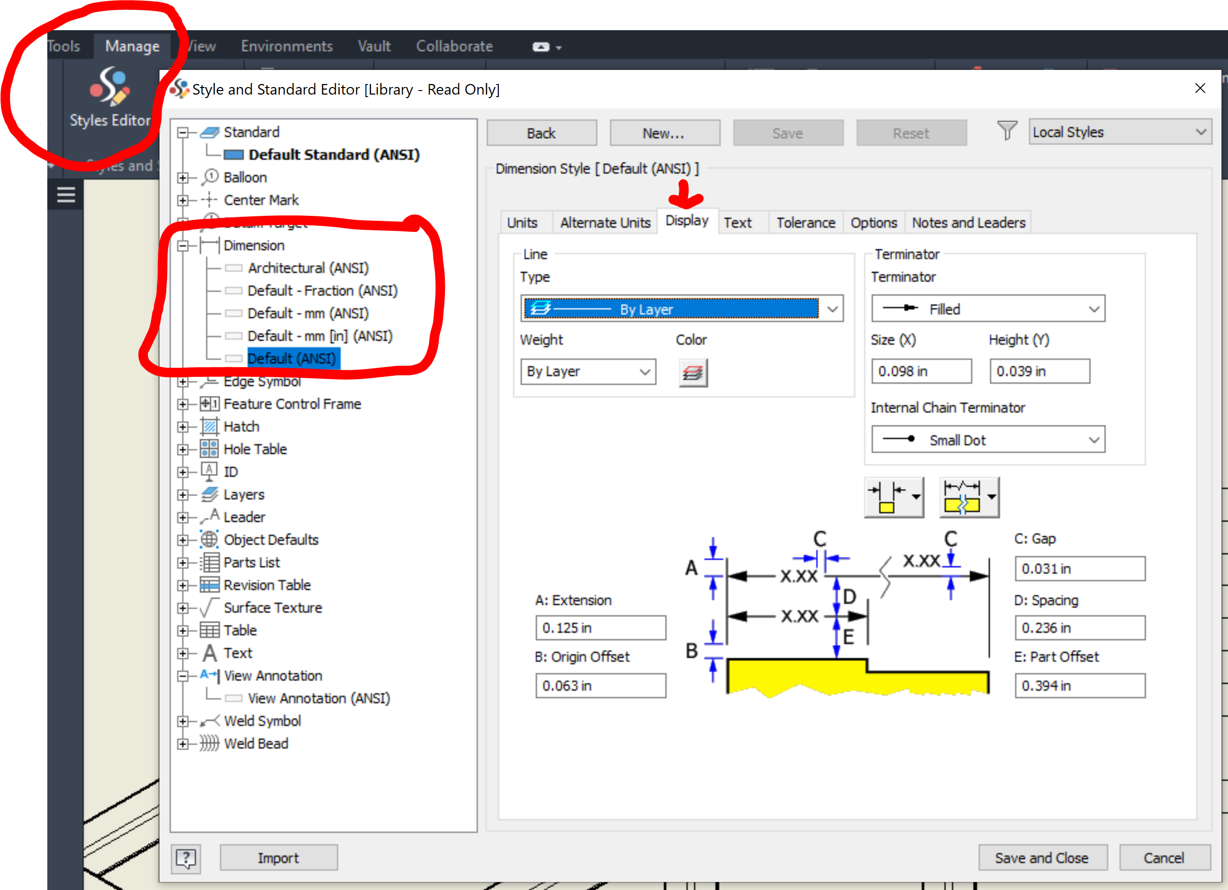

Like the title says, how do I change the spacing between dimensions with the arrange dimensions function (if possible)? When I use it they are too far apart for my liking.

Hi:
Manage>Style and Standard Editor>Dimension>Display>D: xx mm
Admaiora

shane.maxwell
Styles and Standards does not have a Dimension option.  I see dimension option in Styles Editor, but there is not a Display option under that Dimension tab.
@admaiora is right. He provided the exact path to changing this setting.

CGBenner
@shane.maxwell
Welcome to the Community! I think this may help guide you to the path mentioned above: Note that you need to select a specific Dimension Style first.  Good luck!

shane.maxwell
Kacper Suchomski
The path provided by Admaiora is excluding a few things and is confusing
@ Chris Brenner
Thank you for a response that was actually helpful.
