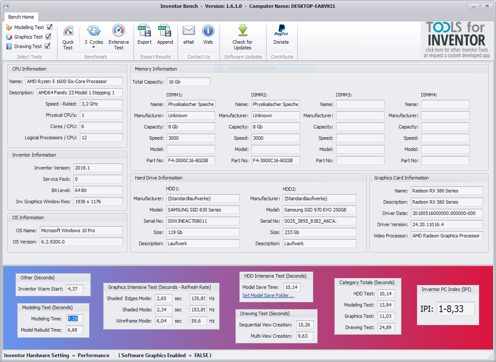

Hey guys,
can you check my bench? Is there something I can do better? The HDD-Score seems to be a bit weird for an NVMe, or am I wrong??
Thanks!

Neil_Cross
Saving files isn't just a straight up "write to disk" operation, it would finish in a fraction of a second if it was purely on how fast the disk write metrics are, it's the CPU which mostly dictates the save performance.
That's actually not a bad overall score, my Ryzen7 1700X is pretty much in the same ball park.
