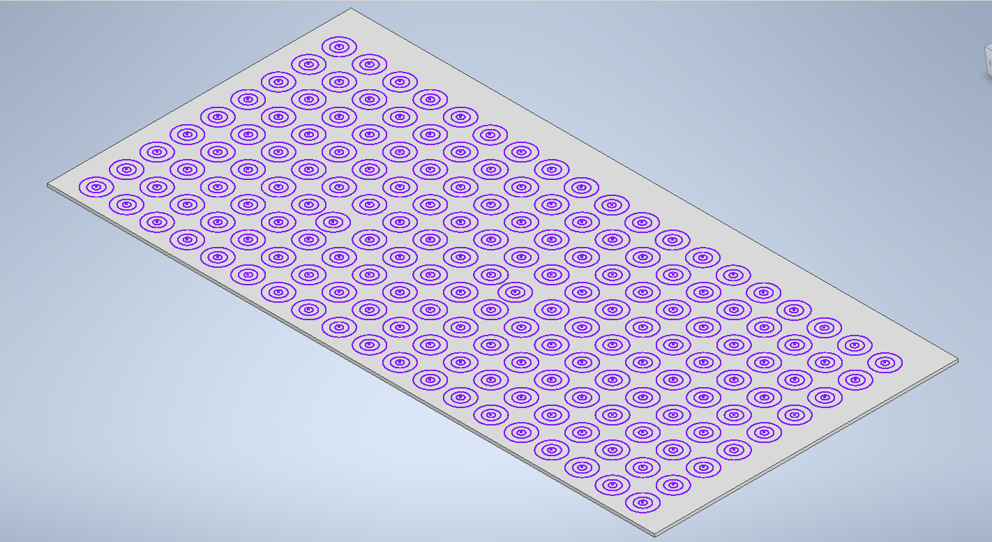

EndlessStruggler
Thanks for replying.
I see, patterning elements. I'm not too familiar with that but I have attached my file here.

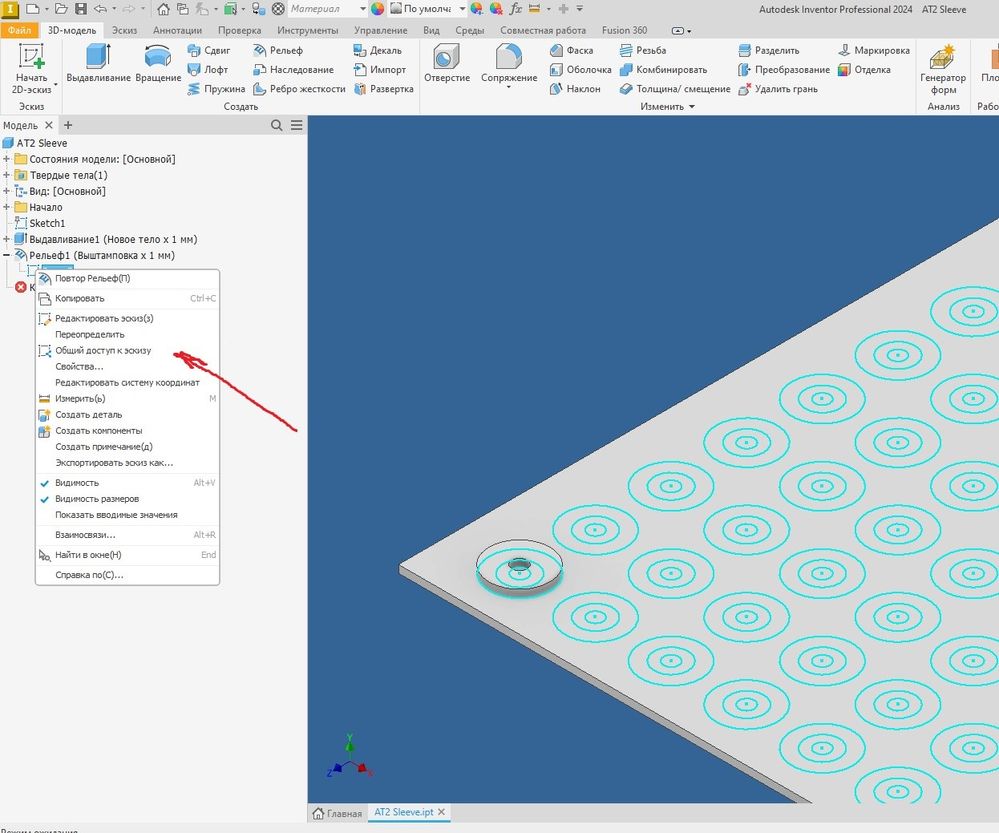

89198826955
Option 1: Sharing a SketchБезымянный.jpgoption 2: array of elements

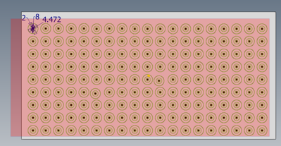

EndlessStruggler
None of them have disappeared but when I perform the extrude/emboss action they do. I have undid that so that they're all here in hopes of finding a more efficient way of getting this task done. The first circle is in the top left. The outer circle is 8mm in diameter, the middle circle is 4.472mm and the inner circle is 2mm.

Message 8 of 32
EndlessStruggler
Okay, here is the problem file.

This feature should be done as an Extrude, not as Emboss.
What happens if you right click on the sketch in the browser (drill down into Emboss) and select Share Sketch?
