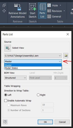

Is there a way to change the model states so the bill of materials from the primary state is used generate the parts list for all model states?
For that, yes. When placing your parts list you can choose which Model State to acquire the BOM from:
