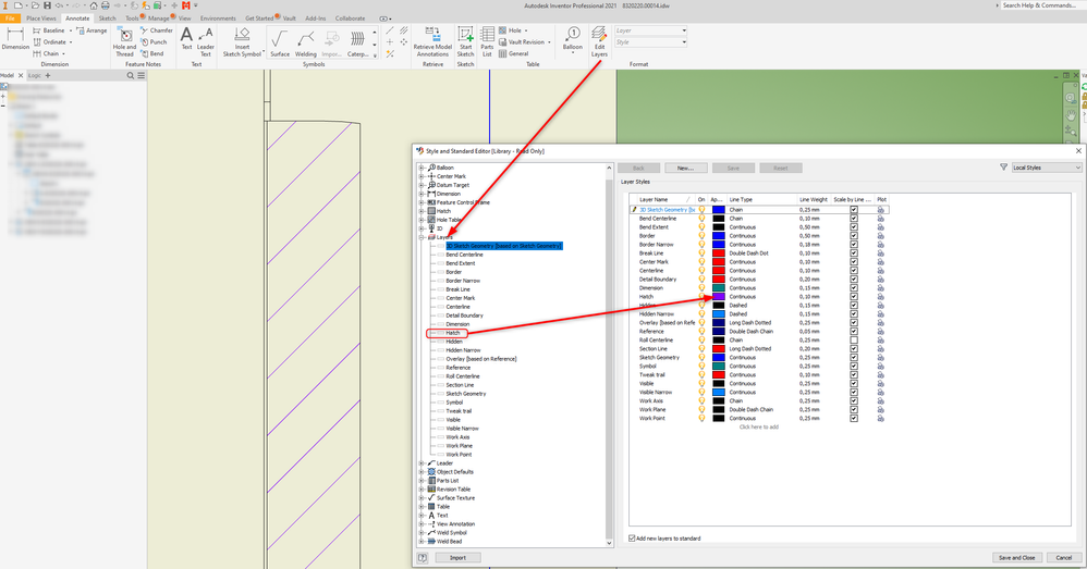

You can change it in several locations:
For an overall color change for the entire drawing, use edit layers:
For individual hatches, right-click on the one you want to change and select "edit" then choose the desired color:

Still not sure if i fully understand the "hatch boundary"... there's "detail boundary" in the layers... could be that...
It's likely part of a layer, if you can select the geometry then it should tell you which layer it belongs to on the dropdown in the top-right on the annotate tab. (next to the "edit layers" button)
