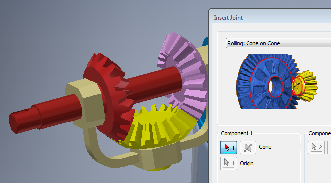

Hello everyone!
I'm new to Inventor 2018 and I can not figure out how to make a certain movement.
I've attached a model of the AeroV2.iam test prototype to assist.
I need the Yellow "Base H" to rotate around the red "Eixo H" whenever the rotational speeds of the Red "Engrenagem Cônica V" and the pink "BevelGearRH:1" are of the same direction (spinning together) or when this component arises as it would in fact occur.
One of the final goal is to make an animation with the "Conduzir Eixo H", "Conduzir Direção EH" and this motion here that I can not do (Be: "Conduzir Base H" ?) all simultaneous for an actual working presentation.
Help here would also be much appreciated!
Does anyone have any ideas to give?
Every help is welcome.

Do you have information for the Pitch cones for the bevel gears?
Have you experimented with Rolling Cone-on-Cone joints?

@TheCADWhispererescreveu:
Excuse me, I'm starting.
What is "Pitch Cones"? The number of teeth?
No, I did not find this Joint, I only tried joints/constraints, is it in dynamic simulation?

the Dynamic Simulation module (environment) allows to simulate kinematics. It is part of Inventor Professional.
To simulate Bevel Gear:
1. Use Design accelerator to generate gear
2. Make its assembly flexible
3. Switch to (Dynamic Simulation) DS
4. Rotation joints are generated/created automatically
5. Define Rolling joint
6. Define imposed motion
7. Play simulation
In you case when you have more degree of freedoms, you can lock some of them - for instance let just 1
See basic workflow - BevelGear.mp4
