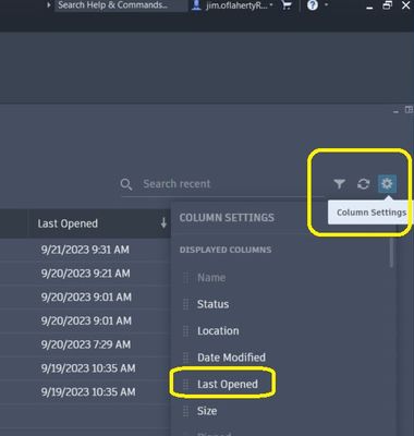

CGBenner
@jeffreyacevedo
I've just been plating around with this in 2024.  Try this:  Set the Home Screen to List View, and then open the Settings icon on the top right (looks like a gear).  Uncheck "Last Opened", and then return to Icon view.  Change projects see if the icons update.  The steps might be a bit different in 2023, but I'm sure something similar is in there.
Chris Benner
jeffreyacevedo
Thank you, but in my 2023 there is no settings gear icon. I looked everywhere. The only settings I can find are the project settings within the 3 dots to the right of the project choose dropdown.
