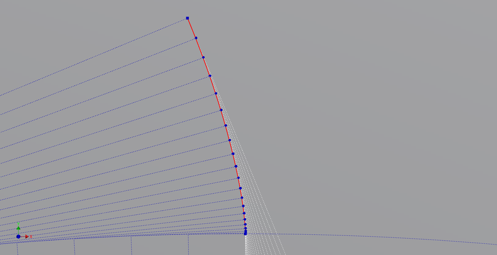

Good afternoon everyone
I wanted to model some contrate teeth which have been hobbed/generated.
Outer radius of hobbing cutter is 6mm.
I modelled the cutter, and  then implanted this 20 times in an assembly which contains the pinion to be hobbed. The aim is to break down the continuous process of hobbing into 20 steps for a half of a single tooth space. This could then be mirrored to create a single tooth, albeit with slightly jagged areas because of the 20 steps.
From within the assembly, I edited the pinion and used copy object to bring the 20 cutters into the pinion part file. I had hoped to use combine to then cut away the material where the cutters intersect with  the pinion. This could be done by either combining the cutters into a single larger object, and then subtracting this from the pinion (the combining didn't work at all - WHY??). Or, individually subtracting each cutter form the pinion using combine: this also didn't work, as combine fails after a maximum of 4 combines.
Alternatively, in the assembly I edited the pinion, and drew a new sketch on the tangential face of the cutter, which gives me the profile of the cutter. I then drew a second sketch at right angles to, and through the centre of, the first sketch, and drew an arc of r=6mm from the tip of the cutter to use a a guide. So I then used Sweep to move the profile in the first sketch along the arc in the second. This worked once, but failed on the second (out of 20!!) cutter.
Can anyone see a way to get this to work, or even see a better way of solving the problem?
Some files are attached
Many thanks
Stephen

During this process, the pinion rotates while the cutter teeth translate, but I believe that the Sweep Solid tool in 2020 will only allow a single solid to be swept, and not 2? So that being the base, it is necessary to move the cutting tooth in a more complex way, thus producing a compound motion of just the cutter which takes into account both the rotational motion of the pinion and the translational motion of the cutter. Please look again at sketch 17 of "BWC2-2001-3 for hobbing". The red lines show the 20 or so progressive positions of the cutter as it creates one side of a single tooth space.
As mentioned before, in my file "pinion 1 space hobbed" you can see exactly what 1 side of a single space should look like. Then I have mirrored this and patterned it 16 times to produce the full array of teeth which you see in "pinion 16 teeth hobbed". Apart from the jagged edges in these 2 files, the shape of the teeth is precisely correct, so if yours don't look like this then something is wrong.
What I really want to know is whether or not the Sweep Solid tool is capable of sweeping according to this complex geometry, or is there another way i can accurately reproduce these hobbed teeth?
Thanks again for your help

What about this:
I have done a new version of the file which is attached (BWC2-2001-3 for hobbing2).
This time, you have the pinion, and the tool is in its starting position. Then look in Sketch 17. Here you have the 21 white lines which show the progress of the cutter as it forms one half of the space. But I have joined up the starting points of these 21 lines using an interpolation spline, which is in red.. So I was hoping that it would be possible to sweep the tool along this spline (using "profile held constant to path"/"follow path" - NOT "parallel") to give the correct profile.
Could you possibly give it a try it with the Sweep Solid tool?
Thanks for persevering with this.
Stephen

stephenmcd74
Hello again Johnson
Sorry to be such a pain. It's just that I am under a lot of pressure time-wise. Changing to 2020 will inevitably slow me down until I get used to it, so I really want to be certain that it will give me a clear advantage, and this stuff is a key area for me.
Could I possibly ask you to please have 1 more try at the Solid Sweep (using the same file: "BWC2-2001-3 for hobbing2" from my last post)? You have not used the interpolated spline as the sweep path.
To help you find the spline, here are 3 images of sketch 17 from "BWC2-2001-3 for hobbing2". The spline you need for the path (using "profile held constant to path"/"follow path" - NOT "parallel") is in red:
I would be so very interested to see the results if you could try this again.
