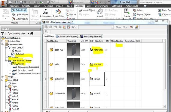

Dnyaneshwar_Maid
Hi I agree with you.
What I thinking is that in such cases can we use combination of BOM - Bill of material keeping part/assembly status as Normal/ reference/phantom with Representations (LOD - Level of detail) in which we can suppressed unwanted part. These setting we will do in .ipt file and while making drawing we will use different setting of drawing view as shown below.
this is a just proposal from my side. As I do not came across any issue where I wanted to show particular edges or lines of particular part. But I always use Level of detail where I can suppress the unwanted part directly which i do not want to show in drawing by defining and selection that LOD
Best regards,
Dnyaneshwar Maid

@Dnyaneshwar_Maid
Changing the part type to reference in order to manipulate the line style IMHO is a really bad idea.
