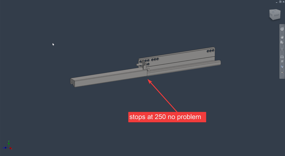

troyostrander
New to Inventor question.....I can get it to stop at the end but not stop at the start which is zero.  See demo video and file.
(view in My Videos)
325 Views
johnsonshiue
Hi! It looks like the Joint Limit is in a corrupted state. I tried changing the lower bound to 1mm and it worked. Then I changed it back to 0 and it also worked.

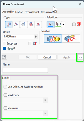

CCarreiras
Hi!
Use traditional Constraints with limits instead of Joints.
Traditional constrains are easier to use, more reliable and expectable then Joins.
My suggestion is: Use only Joins when a task is not possible to do  with constraints, which is very very rare.

troyostrander
Hi Johnson,
So changing it to 1 and back to zero worked! Thank you.
Also I was able to reproduce the bug from scratch ....See demo video Youtube link. Tell me if I can be of any more help. You have the files in the initial message.
