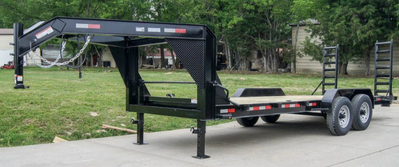

I have been trying to figure out how to draw a gooseneck for a Cattle/Horse/flatbed trailer.
My students and I are stumped.  I am not well versed in cad. We can create simple bumper pull trailer frames but have yet been able to make a 3d Gooseneck neck assembly that we can drop into any trailer assembly plan we make.

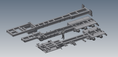

This is a version of a trailer we are working on for next year.

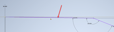

Here is the wire frame.  I didn't draw this correctly from the start I know.
The upright main beams should be a solid line not 2 seperate ones that the neck hangs from.

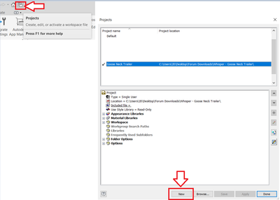

Step 1. Create a new folder named Goose Neck Trailer.
Step 2. Create a New Project within the folder and name the project as Goose Neck Trailer.ipj
Make sure to select the path to the folder Goose Neck Trailer that we created in Step 1.
Step 3.
Create a new part file and name it Goose Neck Trailer - Skeleton.ipt
Right click on the Goose Neck Trailer Folder and select Send to Compressed (zipped) folder and then Attach the resulting *.zip file here.

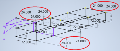

Q1. I don't understand these 24 inch dimensions relative to the image that you posted.  Are you modifying this design?
Message 10 of 29
benjamin_burkhalter
The 24 inch dimensions were for a stacked box frame that would support individual hay cradles. The box frame allows for use of lighter weight/thickness structural tube steel. We shelved the idea due to building time constraints for this year.

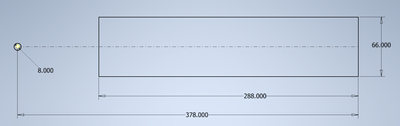

JDMather
@benjamin_burkhalter
You went beyond my instructions - I was expecting an empty *.ipt file.
I would never repeat dimensions like this...
We will make use of obvious symmetry about the Origin.
Let's start with a circle at the Origin.
Then sketch a Construction Centerline from the Origin to the right.
Now sketch a Two Point Rectangle anywhere in space.
Add a Coincident constraint between the right end of the Construction Centerline and the Midpoint of the vertical line in the rectangle as shown.
Add the dimensions as shown.
Attach the new *.ipt file here for next set of steps.
Q2. Is this vertical pipe round or square?
(The pipe welded to the trailer frame.)
If it is cylindrical - what outside diameter?
If square - what outside size?

blandb

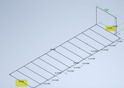

First thing I see is the highlighted below...
If the top dim is supposed to keep the trailer centered then either use a vertical/horizontal constraint to geometrically lock in in position, or do a mathematical operation to make it the width/2. Sketch 2, is this always going to be the same width as the trailer or do you want to control that independently? If always the same, then just project the corners of the trailer, or make the width equal to sketch 1 width. IF not, just make sure to edit that dim.  The first 3d sketch is Empty?  is the top of the gooseneck supposed to be parallel with earth or does it slope down a few degrees as shown?
You could do this with a user work plane that you can either control the tilt if it needs to be sloped, or just make it parallel with the ground. Then repeat for the next section. vs a 3d sketch?
See a quick fixed version, you can always just rotate the top plane down a few degrees if needed. the top goose neck dims are just preliminary, you need to make them what you want. But it all updates.
Also, your sketch 1, is there suppose to be a mis-alignment from the origin to your corner of your frame?
12 x 24 = 288, but you have 287.989?
