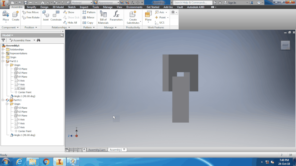

how do i make a workplane to be at 40 degree and also slanted at 10 degree? as you can see below the part 4 is already 40 degree curve from part 2 but how do I make the part 4 also to be slanted by 10 degrees? Please adviceangle blockangle block

i am sorry for asking the wrong question. what i actually want to know is how to make the part 4 to be slanted at 10 degree and and also 40 degree curve from part 2. the picture above only shows the part 4 to be 40 degrees but i need it to be slanted by 10 degree also. Sorry for asking incorrectly previously. please advice and also thank you for the previous information as it was also useful

This is the assembly file. Currently Solid 2 is 40 degree to the Solid 1. I also require Solid 2 to be slanted by 10 degree. Sorry for sending the late reply. Please advice.

I hope this picture below can make you understand. Because I am also not sure how to explain properly. Sorry for that. Thank you

Hi! If I understood your requirement correctly, you probably don't want to create workplanes at assembly level or create angular constraint between two planes. What you need is to create angular constraints between two axes, not planes.

Solid 2 is adaptive to Solid 1, you will need to turn off adaptivity in order to obtain the angles you desire.
You should then be able to create angles between axes as Johnson suggests.
