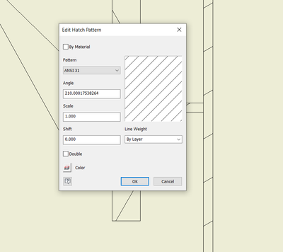

Hi, I'm working with inventor 2021. I have a couple of custom materials hatches that I would like to apply across already made drawings. I have the materials set up in my styles editor, but in order to apply these hatches I need to right click > edit > check the box marked "Hatch by material" on every single instance of hatching on my sheet. I'm working with vault and don't have the necessary permissions to edit or save to the style library, but I only have a couple of presets I want to apply. Is there any setting that will automatically check "hatch by material" for all of my views?
Additionally, I want the default hatch angles to be only 45° and 135°. I've found where to change those in styles editor > preset values > section hatch angle, but the changes don't apply. in the help documentation, it says "Note: The default hatch rotation angles apply on creating section views. If the default setting changes, existing section views keep the hatch rotation angle as a property override." Is there any way to prevent this? delete the overrides? force the section to recalculate and use the new defaults?

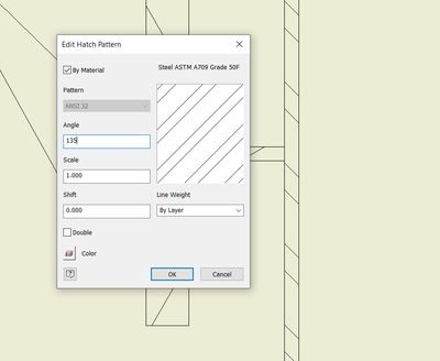

Hi! I can't attach any of the files I'm working on, but I can provide some screen shots and some more detailed information.
 1. Open up the style manager with none of the custom hatches applied.
2. Click "from file", navigate to a .iam that has all the materials I want (side note, why are .ipts the only available extensions in the "file of type" dropdown here? I have to copy and paste the name of the file I want from outside of the program. iams load, but aren't findable from this popout for me).
3. Apply the custom hatches.
4. Remove all unwanted section angles, add 45 and 135. Save and close.
 5. I didn't change the default pattern, so nothing has changed. All of these sections have an assigned material in the model, however.
 6. Ideally, having added custom hatches associated with materials would have ticked the box for "by material", and removing/adding new default hatch angles would recalculate the hatches across the drawing instead of saving all of the previous angles as overrides.
7. Checking the box and manually changing the angle works, but it isn't an ideal solution. I often have over 50 cross section areas of different materials on a page, and right click > edit > tick box > highlight angle > type 45 or 135 > hit enter is way too cumbersome across dozens of sheets, all of which are different files so they can be vaulted and worked on separately. Am I missing some options somewhere?

Hi! I guess the material hatches were created after the section views. As a result, the section view hatch needs to be edited manually.
It is possible I don't fully understand the issue. Please try creating section views after the material hatches are set up. I don't think you need to manually change each hatch region.
