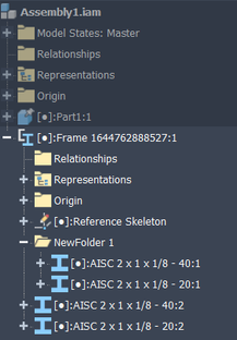

"Add to new folder" option is not available for components in frame generator in the model tree. Is there a way of doing it by using ilogic or any other way. Basically group components in model tree for the ease of browsing is the ultimate goal. I have attached a snap of it below

Highlight/open the frame first, and then add to folder within that:

A quick follow up question to that, is there a way of grouping the iCopy assemblies within folders? Since iCopy are made on assembly level and there is not right click option on that. Aslo, drag and drop does not help.
johnsonshiue
Hi Gary,
Unfortunately, iCopy components don't work with folders.
Many thanks!
