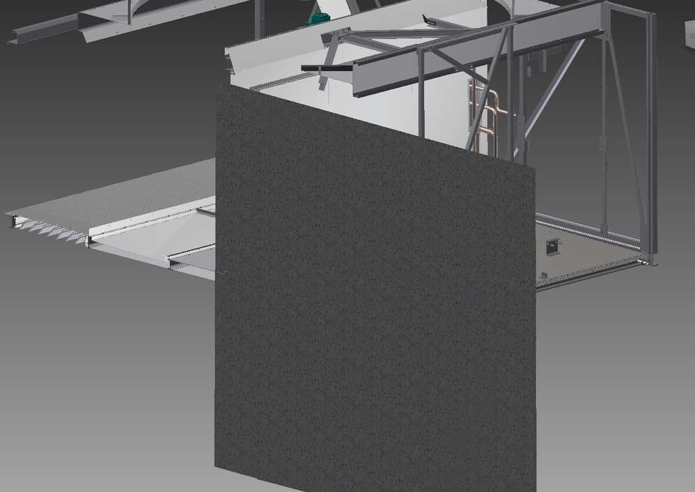

Hi all,
Issue when doing section views in the model. After I create the view I get the attached problem big gray box. it is not just the cross section of a plate because nothing is there in the normal model (see the last pic). I can move around the assembly and it doesn't go away. Now I have been able to get it to go away temporarily by changing the visual style but usual comes back after a few minutes of moving around the model.

Also this is project independent. it happens on almost anything im working on that has more then a few assemblies.

Hi Paul,
This issue has been resolved as of 2017.4 Update. If you have access to subscription site, please download R4 Update and install it. The issue should go away.
Many thanks!

The issue reappeared in 2018 for me, but that being said, I've only had it occur once in the last 2 weeks.

Hi Andrew,
The issue should be 2017 specific. If you are seeing it on 2018, something is not working right. Please let me know if you have repeatable steps in 2018. We need to take a look at the behavior.
