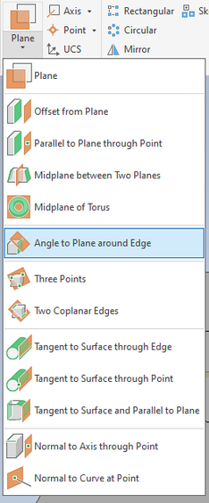

The vertical constraint in Sketch4 I could eliminate. If I understood you correctly, I should generate the workplane via this: ("angle to plane around edge")
where I then select the centerline of the rectangle in Sketch4 as well as the upper (in z direction) face of the sheet metal surface. I get the workplane and everything, however, I can now not even export the punch anymore:
since it doesn't allow me to click "save" anymore. Also it now requires two position geometries (Profile Plane1 and Profile Plane 2) and I have absolutely no idea why.
