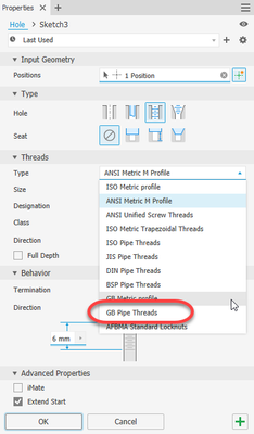

Hi Team
I came across some G6, G7,G8 .. threads.
I couldn't find the G thread above sizes in the hole - tap feature.
Is this available with any other feature?

To see all the thread forms Inventor can access, have a look at the Excel spread sheet in:
C:\Users\Public\Documents\Autodesk\Inventor 2024\Design Data\XLS\en-US\thread.xls
Note:  You might need to change the \en-US\ folder to suit your language installation.  Also note that this is the default location of the threads.xls file - you may (probably) have another copy which Inventor reads wherever your Design Data is installed.
If you looking for "GB", it should be here:
If it isn't there, someone has deleted the tab from the working copy of the spread sheet.  Take a copy from the default location and paste it into your working copy.

I can see upto G6, But I need G8 thread.

Maybe different standard:

@guillermo.martinezC6FK8 wrote:
Hi
Regarding this issue, Can I add other threads type?
For example NPT, I added this for screw but I would like see this information in this box.
Thank you
Yes.
NPT is in the files already.
I added AFBMA locknut thread size.
You can see it beside GB pipe thread on my screenshot.
