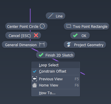

3. How do I select single lines within constrained geometry to offset?
Turn off Loop Select (don't forget to turn it back on later).

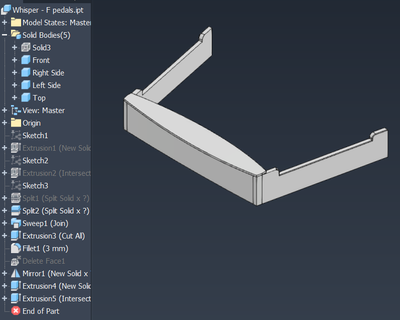

I've done it again I'm afraid. Simply not understanding how to constrain geometry which at my level is quite complicated has resulted in my being unable to extrude parts of it when required. I've attached the .pt file you in the hope that you can repair it for me and I can then have a closer look at it's constraints and hopefully learn from it.
ps. This model represents about 6 hours work so I'd like to avoide starting from scratch of possible.
all best
Luke

How did you arrive at this angle (and how will it me measured in the real world - what measuring instrument)?
What is the purpose of the sketch pattern?
Message 14 of 24
JDMather
Examine Sketch1 in the Attached.
What do you observe about the sketch?
Message 15 of 24
JDMather
Edit Sketch2.  What do you observe?
Delete Extrusion2 and Extrusion1 (uncheck option to delete the sketches).
Note that the sketches were created without dependency on the extrusions - deleting the extrusions does not cause the sketches to "go sick" (turn pink and indicate an issue in the browser).
Message 16 of 24
JDMather
So, as I move along and try to decipher your Design Intent - I decide to move Sketch1 Origin location and add two angled lines.  (To move I simply deleted the Coincident and redid it to new location, nothing fell apart because I fully defined my sketch such that any edits I do would be robust and predictable.)
Note that I seldom create any Workplanes.  I did your Splits with a sketch.
Message 17 of 24
JDMather
...I start to really struggle with trying to figure out how you arrived at certain dimensions...
Sweep is normally done from profiles perpendicular to path.
I question that this is really really your Design Intent when I see a Sweep profile that is not normal to the path.
Message 18 of 24
