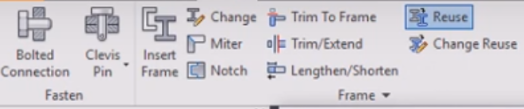

Could do that in 5 minutes using frame generator + drawing time.
Frame Generator in a nutshell.
You draw a frame as a line sketch.
Save that
Add that part to an assembly
Start frame generator and choose your size
apply to the lines
apply mitres/cuts
Done
Any holes need to be done at part level not assembly level so you need to double click to drill down to just the part you want to drill.
This will produce an assembly and all the separate parts to go with it. For identical parts there is a reuse button too.
Just be aware that if you change the size of any of the members at some point, it will create brand new parts, not update the original, this can fill up storage if you do it a lot.

Thank you for the play-by-play, So the support members & mounting member will obviously be re-used 9 times, would that mean that I should only make a line sketch for one of each and then just pattern it?
Message 8 of 15
SharkDesign
in reply to: drawingsCHR7R
I try not to use patterns in frame generator. Just use the sketch the the reuse button if they are identical.

You need the sketch to do a reuse

I understand that, what I am asking is does the skeleton sketch need to have all 9 sides that are the same or can I just do one and then reuse to do the other 8?
Message 12 of 15
SharkDesign
Sorry, I replied to this a second time to clarify but it didn't post for some reason.
You need the full sketch. When you click reuse, you'll click the member you want to reuse and then click the sketch line to position it.
This is actually no longer true unless you want it to be.
One of the more recent versions (I'm fuzzy on which - I skipped all the way from 2018 to 2021.2) added an option called "Overwrite current file for size change".  If this is turned on, changing the size actually does update the original file (or at least saves over it with the same name).
You no longer get the excess files from size changes, unless you leave that option turned off.
