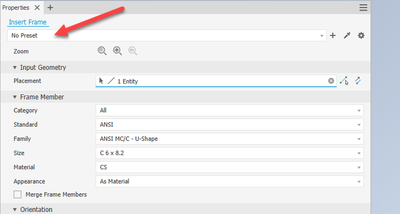

blandb
At the top when placing, does it state no preset, or was there a preset used during placement?

blandb
I just did a test and when I placed my first member I had to move it to the center node, then when I went to the second assembly, it remembers the same orientation I set the first time when placing the second member in the second test assy, I didn't need to choose the center node and I had no preset.
