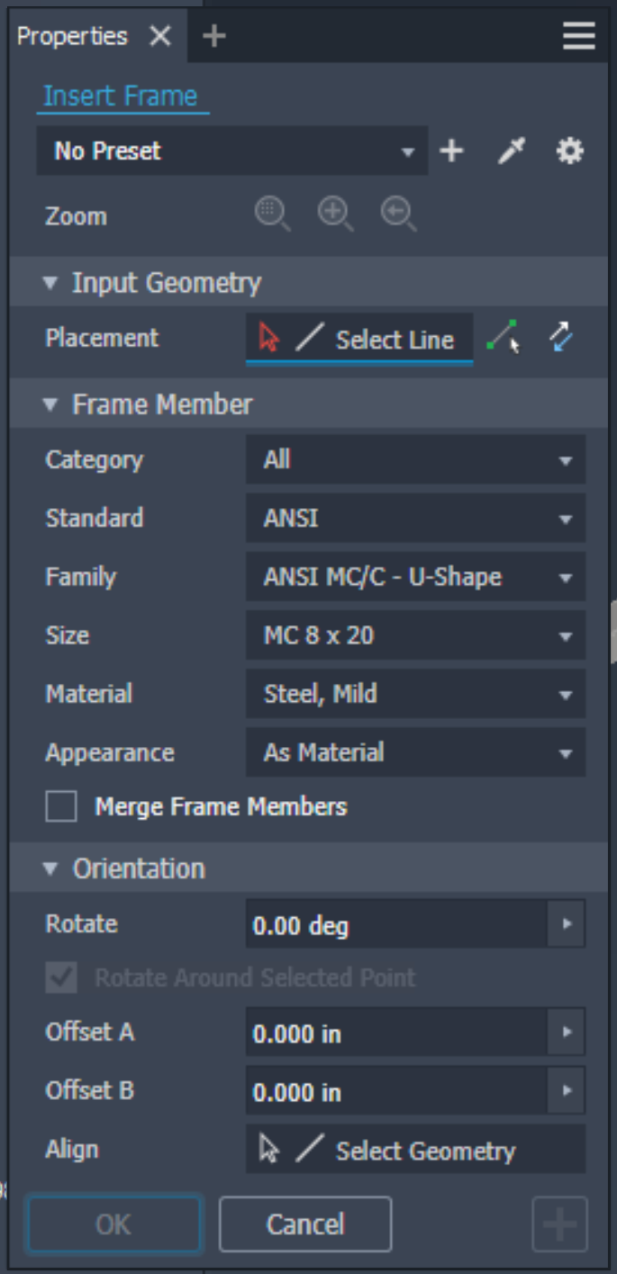

I can select lines in the skeleton, but there is no preview and the OK button is greyed out.
I can't get it to generate anything. I can open older assemblies and all the elements are there and work as expected. I've tried both 2024 and 2025 versions of Inventor, but same issue.
I cant see anything out of the ordinary within the project settings.

Hello.  From your image it almost looks like your Content Center library is not available, you should also see Standard, Family & Size in your dialog box.  Can you share an image of what you see under Category at the top, where it says All?  Also, check your Project t make sure all of the Content Libraries are available.

I just created a new project in the same folder and it's all working. Not sure what happened with the originals, but I'm just going to roll with it.
