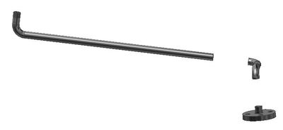

I have a piping assembly in inventor. This piping is divided into two separate sections (I don't use the piping tool because it wouldn't be applicable for this type) with a coupling in between. The first section is set with a 2 degree slope (first picture). this couples to a different section that is at a 2 degree slope until the end where it becomes parallell to ground (Second picture). I have assigned constraints on the parts with a max/min distance of +10,000/-10,000 so they are flexible and assigned no angle to it. These two combine in an assembly with the second section as flexible so that I can adjust the pipe lengths as necessary.
Section 1Section 1Section 2Section 2
The square flange will be attached to an object and the end piece on a different object. I've tried it using a single assembly where it worked, but with these two separate assemblies it doesn't want to work. When I attach the flanges to their respective parts, it wants to sit like following:
However, I don't want the second section to be angled like that, I want them to be parallell. When attempted, this fails though.
Due to confidentiality I cannot provide the assembly files, I'm sorry to say. but I can provide any other information that may be necessary.

Many thanks for sharing the files! I took a look. I am still trying to understand your request. Is it about not being able to rotate "DIN 2982 R-208 Welding nipple ISO Taper:1" 90 deg? If yes, it may have something to do with Angle:2. It prevents rotation from happening.
Could you elaborate what exactly you were looking for?
Many thanks!
Software Test Engineer
Message 7 of 21
Angle 2 is there to ensure that the section is constrained parallel to to the XY plane and thus not able to rotate on the axis of the flange. Together with Flush: 2 and Mate: 2, this ensures the angle of the welding nipple. I found this way to be the easiest way, but maybe it's not the most proper way.
The issue is that when I constrain it to section 1 and to another part further away, it get stuck in an angle, as demonstrated in the original post, and I cannot change the angle of it, which should be possible due to insert: 2, Insert 3, and Insert:10 being as flexible as they are. The constraining to section 1 and the second part is only an insert constrain, without any angular constraint. When i try adding an angle 0° to a plane I want section 2 to be parallel to, it fails.

Many thanks for sharing the files! I see the issue now. I think this has something to do with grounded components. There are two places in the assembly with excessive grounding. 1) DIN EN 1092-1 TYPE 02 Loose flange PN 10 1.4307-15:1 at the top level is actually grounded. Right-click on it and uncheck Ground. 2) Within Section 2, the first component is also ground. Uncheck Ground.
After that, the assembly should work desirably. Could you try it and see if you are seeing the same behavior?

Many thanks for the explanations! They do make sense to me. But, what about Angle:1 at the top-level? It seems to conflict with how the components are constrained. Is the angular constraint needed?

What I want is for "Seamless pipe 21,3 x 1,6 - 544:1" in Section 2.iam to be in the same YZ plane as "Seamless pipe 21,3 x 1,6 - 200:1" in Section 1.iam. Angle:1 in Main assembly.iam is there to make sure they are in the same YZ plane as each other.

I think there are conflicting constraints. Here is the proof. Suppress Angle:1 at the top-level. Then measure the angle between the two supposedly parallel directions. You will there is a small angle. Either you need to change the geometry or change the way the components are constrained.

@johnsonshiue Does the Explicit Reference Vector angle constraint option solve better than the Directed Angle option in flexible assemblies?
@Anonymous Why isn't DIN EN 1092-1 Type 02 Loose Flange PN 10 1.4307-15:1 orthogonal to the origin planes of Section 1:1?  As I open the Main Assembly file, it sits at an angle to Section 1:1.
If I constraint that flange with explicit offsets from Section 1.iam, then I can enable Mate:49 and Insert :86 in the main assembly.

@johnsonshiue I am aware that it seeks that angle. I mentioned it in the OP. However, by all logic, it should be able to sit straight rather than at an angle.
@swalton Thanks for checking. I didn't notice the angle. That was a mistake. However, upon fixing it, the errors persist. You say you manage to get it working this way, could you attach the assembly file for me? Thanks in advance

Here is my solution in Inventor 2019 format.  I had to do a bit more to get a full solution
I cleaned up the extra constraints in the Section 2 Assembly that made it hard for the constraint solver to resolve.  I also made sure that the insert constraints flowed from the grounded component to the final straight fitting.
