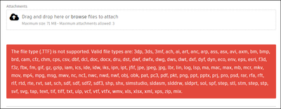

Sorry, I tried to copy the new font file here but *.ttf files are not supported.
