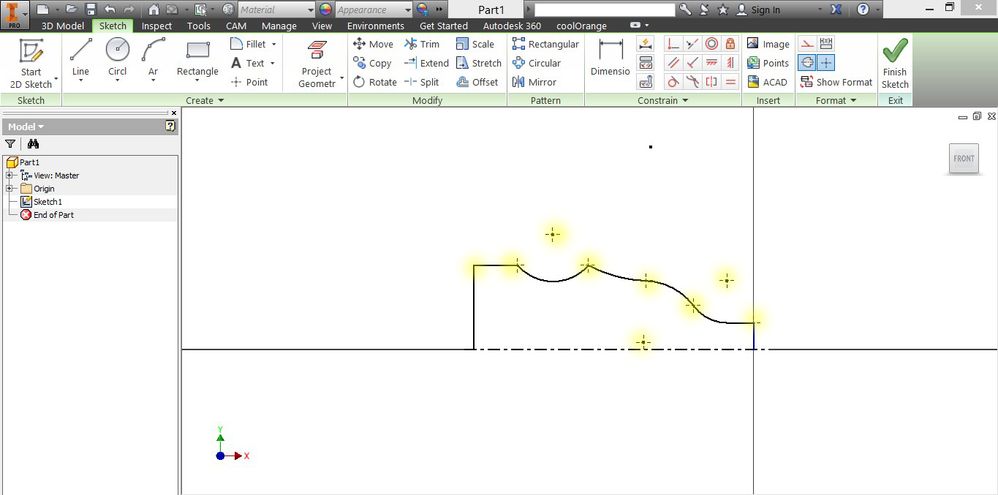

Hi all, is any way tio export 2d sketch coordinates in to excel file????
Inventor has the provision of exporting 3d sketch coordinates to excel file which i already explored but from 2d sketch i didn't found yet..

I didn't know about either functionality.. But worst case workaround is to create a 3D sketch, include the geometry and do it that way 🙂

Welcome to the forum.
Take a look at this link and see if it helps you.
https://knowledge.autodesk.com/support/inventor-products/troubleshooting/caas/sfdcarticles/sfdcartic...
