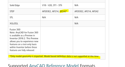

@johnsonshiue Johnson the confusion here (I bet) is that one would expect that if you can export to the 242 format that you could import it fully too (geometry + MBD information)..
I haven't found where its clearly documented that Inventor does not fully support the MBD aspect of the 242 format..
I found this yet I don't see any footnote or anything showing that you don't fully support importing 242 step.. Just a check mark making it seem like you do..
https://knowledge.autodesk.com/support/inventor-products/learn-explore/caas/CloudHelp/cloudhelp/2018...
I know for a fact that the MBD information IS included in the exported STEP file because I can open it in your competitions free viewer and see the MBD annotations..
But do so in Inventor and well... nothing..
This is one of those "half finished" complaints I have about Autodesk.. You have had some support for the 242 format for years now but still don't fully support it even after introducing MBD in Inventor.

johnsonshiue
Hi Brian,
You got a good point here! Although it does not say STEP 242 is not supported, it also does not explicitly say it is supported. There is room for improvement in terms of how it was communicated. I will work with the project team and see what we can do.

We're certainly aware that we don't support import of 3DA/MBD data.  However, to describe this in terms of being "fully supported" or not is to not understand the scope and evolution of the 242 standard.  The standard itself is still changing and evolving and the scope of what is covered in 242 is massive and I'd be very surprised if any CAD vendor could claim "full support" even on export alone.
The reason we don't currently support 3DA/MBD import via STEP 242 is just to dollars and sense.  Import doesn't come for free with export.  It's a lot of work and (more importantly), we (as a product team), don't understand the use case for import yet.
We still have a lot to learn about how users expect to use our 3DA and MBD tools, but we did implement export of these data via 242 because the down-stream workflows were obvious.  Product Manufacturing Information exported in 242 can and will be read into CAM, CMM, tolerance analysis solutions, etc.
Upstream workflows- we don't have as clear a picture of the use case.  We've done a lot of musing internally over the things user *might* want to do with imported MBD and 3DA, but not enough to invest in this area at this time.
That all said, I empathize completely.  Because we don't support import of 3DA / MBD, we have no way for you to validate that the export was successful.  I believe that is a valid use case, but in all likelihood, we'll need better justification than that to invest here right now.
