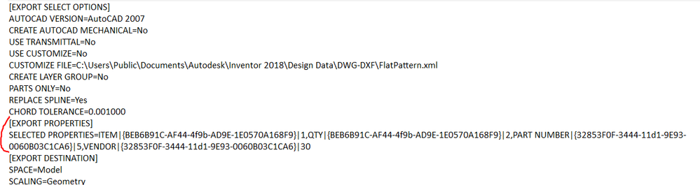

I was comparing to another INI we have here for AutoCAD DWG export:
So you can probably use that format. Add the "[EXPORT PROPERTIES] line then list SELECTED PROPERTIES = whatever you would like. The problem seems to be what are those codes following each one, which look like registry entries... I am not sure. I hope this adds one more piece to the puzzle, good luck.
P.S.: a good overall guide to these INI files below (no codes for properties though).

Is this the iProperties you are looking for? This is found under Drawing Utilities Drawing Properties in Autocad.
These iproperties only show up if the Inventor  .dwg file is exported to .dxf. These are only iproperties of the drawing so if these have not been transferred to the drawing from the .ipt then those will be missing.
If this is different than you need can you post a few screenshots of the workflow you are using.

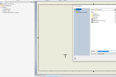

The short answer is I don't think you can. Creating a dxf from the flat pattern by either exporting face manually or using dataIO has no opportunity to export iproperties. It looks like these have to be stored in the drawing as you are accessing them through drawing utilities in Autocad. I do not use any of this functionality so there maybe work arounds out there.
Here is the VBA method to save as from DWG to DXF
https://help.autodesk.com/view/INVNTOR/2021/ENU/?guid=GUID-12B9A89D-7233-4529-A69A-271BA2038670
Here is the VBA method to save as from Flat Pattern to DXF, note the argument options do not include iproperties
https://help.autodesk.com/view/INVNTOR/2021/ENU/?guid=GUID-9F5075D3-00C5-47B3-8BF9-F97E8680B39E

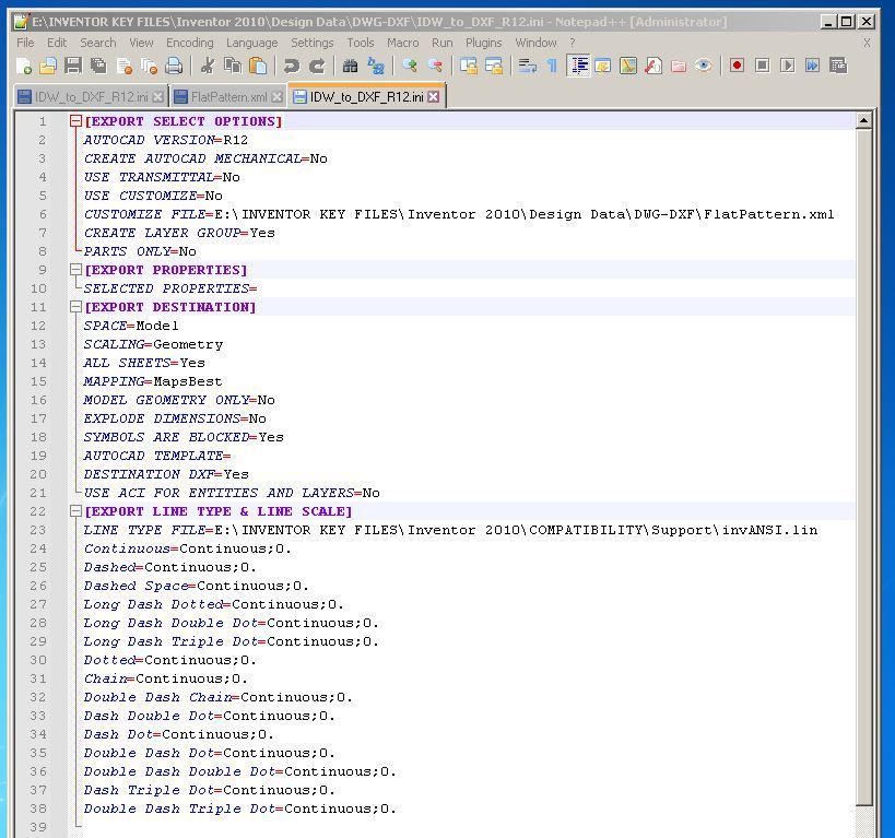

OK, I did a SaveCopyAs on an IPT flatpattern, and in the process set up the options and saved the INI file.
Then I did a SaveCopyAs on an IDW flatpattern and attempted to use the INI file from the previous operation.
The result was an error ''invalid ini file format', which means that the ini files are not interchangable/compatible btw the two DXF processes. So apparently the IPT translator vs. the IDW doesn't use the same ini file. So now I'm back to square 1 on this.
So I ask the same question: Where can I find the secret syntax to add to the IDW>DXF ini file that allows me to (for example) make all the profiles into joined polylines?
Here's a screenshot of my ini file:
I already get that the xml file controls layers and layer properties.
@Gabriel_Watson already gave me info on many of the Options.
But some of them are missing, and they may be useful.
Any idea where I can find a line-by-line explanation of the above ini file (the 'line type & line scale' section is self-explanatory) that shows all the options and what they do?

I had another attempt at this and wasn't able to get the inventor ini file launched from the flatpattern to be compatible with the dxf export from the drawing. My thoughts are they are not interchangeable and maybe that is obvious but worth a shot exploring.
So I think the options for ilogic are to build out the dataIO method and do without the iproperties. Or to work with the Autocad. Ini file and do without the MergeProfilesIntoPolyline and gain the iproperties.
Manually there is still the  method to use the inventor.ini file manually from the .ipt file.
