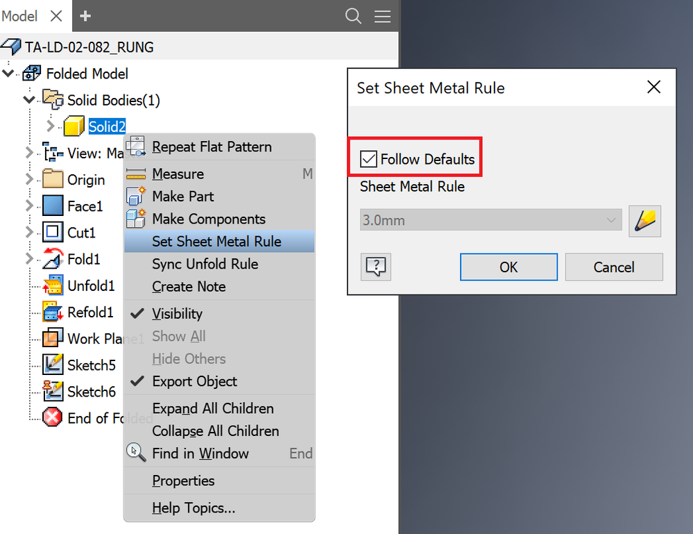

Hi! The second part has an issue because the solid body has "Follow Defaults" option off. Go to Solid folder -> right-click on the solid body -> Set Sheet Metal Rule -> check "Follow Defaults."

Xun.Zhang
Go to solid node and set the Sheet Metal rule, check ON the follow default rule.

baliasM74U3
Thanks a LOT. It worked.
