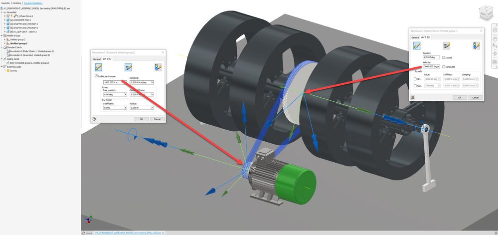

On a separate note (at the risk of looking such a generous gift horse in the mouth 😬), I'm setting up the second side of the system now, and was able to get everything setup and working, similar to the first side (a couple revolute joints, a belt joint, and no need for the prismatic in this case), and it kind of works...  While my assembly interacts correctly in dynamic motion mode (components move with applied force when dragged), the "initial forces" aren't behaving correctly in the actual simulation... In the model, I have the same flywheel array from the previous post linked to a generator via a chain drive. Both have revolute joints at their respective mockup shafts, with a belt joint connecting them.
I'm trying to set an initial velocity (Flywheel Array) of 500rpm, and am setting the Joint Torque of the Generator side to 1000Nm... Although this torque decreases with speed, I'm only trying to model the scenario (for now) to graph the velocity decay with this static drag torque value in place.  I'm not sure this is the most physically correct way to do it (alternatively, a friction value for the generator joint?  Some dynamically defined curve like the table above in one/the other of these two approaches?)... I'm definitely open to your thoughts on this if you're open to providing them...
In any case (ACTUAL question lol), upon activating the simulation, the assembly counter-rotates as expected (the joint torque setting seems to counter-rotate the jointed assembly as expected, if not really realistically, since it's a constant value, which is fine)...  However, when I manually set the initial velocity of the flywheel's revolute joint to 3000deg/s (500rpm), the flywheel starts abruptly, comes to an instantaneous stop, and then begins counter-rotating with the action of the other joints constant-torque setting.  Any ideas on why this is happening?  How do I properly set an "initial velocity" for a component in the simulation, such that I can observe it decaying under the other loads present as function of time in the output graph?

JDMather
@inventor97VJT
You have to use the Input Grapher to define the motion.

inventor97VJT
Thanks Again @JDMather!  After tweaking with it a bit this morning I was able to get it to work!  The simulation is definitely affected in a (relatively) expected way by the Joint Torque formula I'm using...
My only question (in your opinion/experience), is this an appropriate (or rather, 'best') approach to accurately simulating the effect of a known Drag Torque imposed by a generator in operation?
I've used this formula to relate to the velocity of the joint, in an effort to closely approximate the Drag Torque value as a function of said speed: (((V[1] (Revolution:1)*.16))/2)*-1
This essentially is derived from the known Drag Torque/vs/RPM from the generator spec (about 1/2 the RPM in Nm), and I'm multiplying it by .16 to convert to RPM from DEG/s, then multiplying by -1 (to make it an opposing force)...
Do you think this is an accurate way to simulate the approximate decay in Angular Acceleration imposed by the generator?
Is there a better or more accurate way to simulate this that I'm unaware of?  Friction setting of some sort?
Thoughts?
