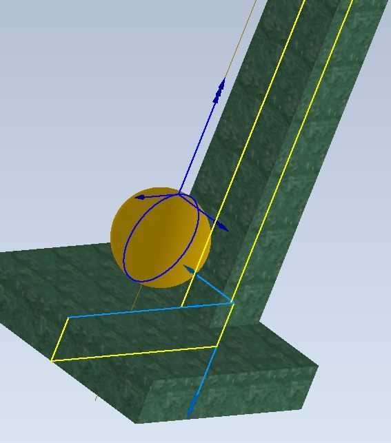

For 2D Contact Joint you need to think in my term as "Fences" that extend to infinity.
The fence profiles must be co-planar or on parallel planes.
For illustration purposes I added a "keep-in fence to your ball drop problem.
Then I turned it sideways to illustrate next to the previous Planar Joint problem.
Note that the two problems are essentially identical when viewed as "Fences".
The only thing that has changed is the orientation of the fences.

JDMather
Z is incorrect in both of those images.
Z should point to the outside.
The outside of your ball would be with Z pointing out.
Since you want to keep the ball outside of the "fence" the Z should be pointing out of the "fence".
(If you wanted the ball to stay inside of a "fence" the Z would be pointing inside the fence.  X and Y directions don't matter in this case.)

I think that you are getting confused by the length of the arrow (depends on zoom level).
Look at the origin of the triad.  The direction is...
