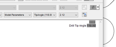

There doesn't seem to be a <Formula> for the drill tip angle but it is a parameter stored for the part that you could access with a leader or text added to the hole leader (right click on leader after placement and select text)
Not really what I was looking for, but it will do for the time being.
I still hope they'll implement a proper <Formula> in future versions.
Thanks Smiley Happy
