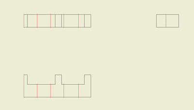

I have an assembly made using the Frame Generator feature. Within that assembly file I have created some view representations. These view representations are used to create a drawing package. I added breaks to some of these drawing views to fit them on the page.
The problem I am having is that whenever the parts within a view representation move within the assembly (I am changing other part lengths and am not modifying any of the actual parts within the view representation), the center location and length of the drawing view break changes such that important information is cut out and/or the drawing no longer sits entirely on the sheet. Is there any way to avoid needing to fix every drawing sheet every time the assembly is edited? Does anyone know if this is an issue outside of frame generator assemblies? This problem even happens when I just move an un-grounded assembly relative to the origin point without editing any parts.

I have created a simplified assembly that exhibits the same behavior.
The highlighted part is the grounded part, and the top piece is constrained to its top. I made a view representation consisting of just the top part and made the following drawing from that view representation with the view breaks shown in red.
Now when I change the extrude length of the bottom part from 10" to 30":
The drawing changes to this:
I have attached the files here as well.

This is normal operation for Inventor, I don't think its an issue, as Inventor cannot maintain your design intent all the time.
You will just have to drag the break back into the correct location, sometimes this can be very difficult, and occasionally quicker to redo the breaks.
There is no way that I know of, on how to constrain the break line, this would be great, perhaps something for future versions.
I personally create sketches in my views to indicate the break points. (My reasons are different  though, I have to attach tube end symbols to the break points, and I can't anchor the block to the line end, so I have to make a sketch, and anchor the block to the sketch, I make small lines of 0.01mm long)

Many thanks for sharing the files! It helps me understand the issue better. As Reg and Gabriel already mentioned, this is a limitation. The break view and crop view are more like a way of manipulating the view port, as opposed to cutting the actual geometry. As a result, the break lines are not associated to geometry at all.
