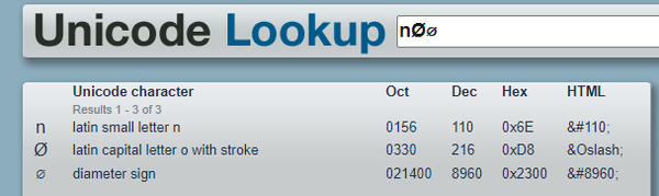

How is it that the diameter symbol is different if it is placed automatically by Inventor when I create a dimension versus when I click on the diameter symbol myself? Are different Ascii codes used?
5 REPLIES 5
I agree, this is strange. I've been digging through the styles now for a little while and it's Arial everywhere, but when the system generated symbol (seen in the box below) in the Styles editor is copied to Notepad or the forum textarea, all you end up is "n".
The manual input symbol is actually a standard alphabet character, Ø, as seen in Danish or Norweigan. The proper diameter symbol isn't used at all...
https://unicodelookup.com/#n%C3%98%E2%8C%80/1
Side by side:
@matz_anderssonW3LBY @EdvinTailwind
Hey there.  I did some asking around internally, and the explanation that I got was that the symbols in Dimensions will be based on your Dimension Style and the Note Text(ANSI) style... symbols from the symbol chooser menu use AIGDT font.  To get a consistent look between your dimension style and the symbol style, I was told to use the Diameter symbol from the symbol menu... but NOT the top one.  Choose the one shown below.  I've done some testing using the base Tahoma font for my dimension, and added this symbol to a diameter dimension.  They look the same (second image).  Give this a try.  🙂

The three symbols at the top of the chooser, highlighted in dark gray, are selections from the current editor font.  The other symbols are from the AIGDT font.  Inventor dimensions use the AIGDT font, which has the slashed O in the same character position (ASCII hex code 6E) as lower case n in normal writing fonts.  The slashed O in normal writing fonts is at hex code D8.
The degree symbol (°) and ± symbol are the same codes in AIGDT as in normal writing fonts.
