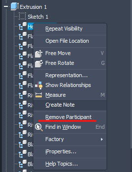

You can also add participants to the extrude which I showed in the video after the fact but I didn't show how to remove them from the extrude, basically you can right click on them and select "Remove participant" as per the below image
