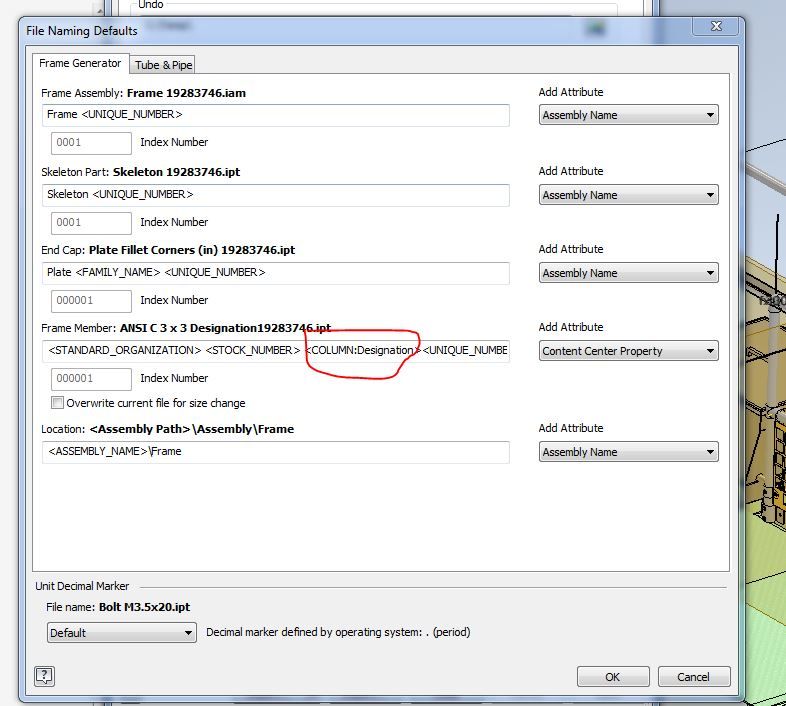

With frame generator, the display name is done in the frame generated workflow steps when you have prompt for filename option selected.  It does not use the display naming mapping in your content center

Hello @alexandru.spinu3KN9U to add to what @Mark.Lancaster suggests you can skip to 9:50 and it shows how to rename the browser node to the Frame Generator filename.

remove COLUMN: and try just Designation see if that works.

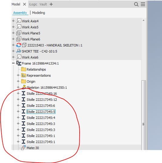

I want to customise the name of the frame member in the position shown here -
The process above doesn't change the name in this position it changes it in this position in the iProperties. -
These are 2 totally different places.
