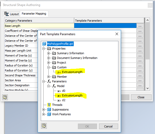

I think I do everything by the book.
  • I create a custom read/write library
  • I create a new part with a rectangular sketch as a profile
  • I author the part as a Structural shape
  • I publish the part and map the base length as "G_L" parameter that the authoring created... or do I use my own extrusion length? Does not seem to make a difference anyway.
  • After publishing I can use my custom frame member with the frame generator and make a drawing and add a parts list.
It calculates the total length in the QTY column correctly... but if I add a UNIT QTY column, then the custom frame has a value [*Varies*] while the ISO frame has a value.
What am I missing? Why is my frame acting differently?

I am really interested to "Change iProperties of the parts that are being combined to have different part numbers"
I noticed that the ISO frames have the length in the part nr and this is what creates unique rows for them.
My frame does not… It creates a single row that has varying lengths.
I tried to add an expression to the frame member part nr field [=MyPartNumber_&_<B_L>] before authoring as a structural shape… but this expression is lost on the parts that are created through Frame Generator.
I want exactly the same behavior as the ISO frames… how can I do that?
Not merging the rows would make a very-very long parts list.

One thing that is maybe worth pointing out…
While authoring I can pick my Base Length parameter… And I pick my extrusion length.
Now authoring changes the structure of the part and creates this G_L parameter, Start and End work planes etc.
After authoring I can publish the part to the Content Center... and one of the first steps during publishing is asking me again what parameter I want to use for Base Length. And now I could use the extrusion or I could use the newly created G_L parameter.
The outcome seems to be the same… I am just wondering if there might be a difference whether I use the original extrusion or the G_L parameter.

Does it matter if during the initial authoring I pick the "ExtrusionLength" under iPorperties or under Fx Parameters.
After authoring and before publishing I have more options.
What do I choose?
