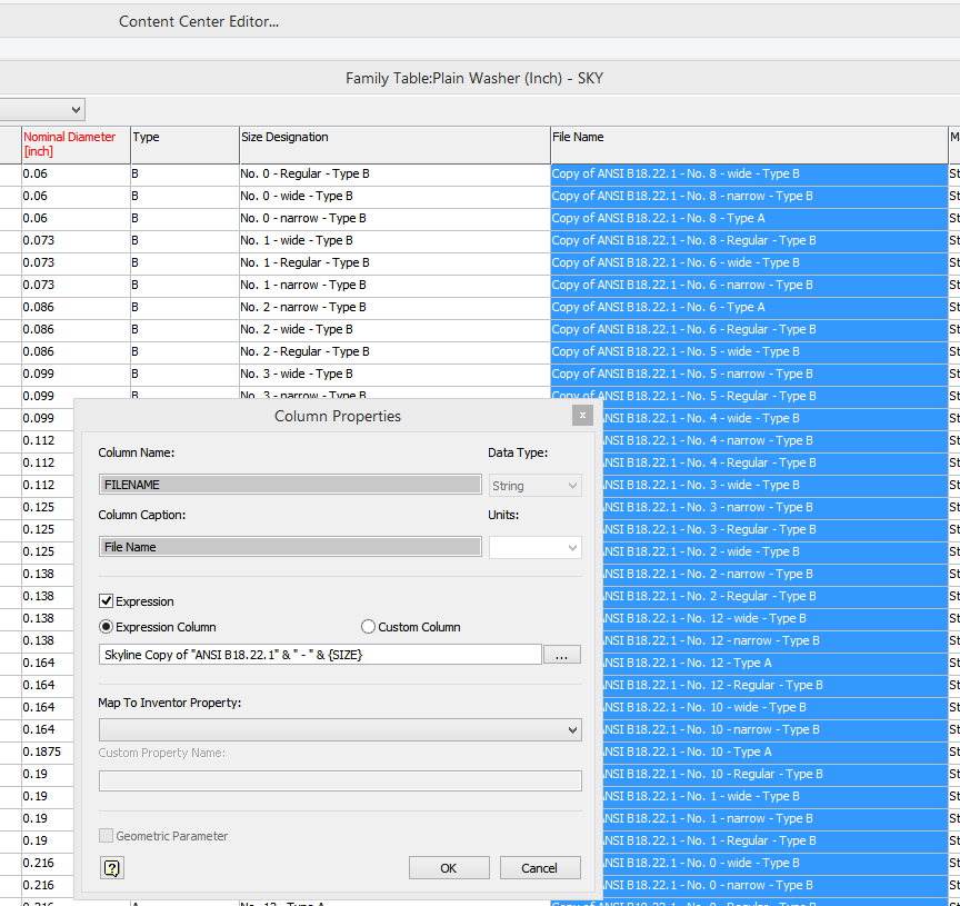

I copied a family of washers to our own library, using the "save copy as..." and altered the family name and folder information by using a "-SKY" modifier, and allowed the default file naming mapped to the new family folder.
When I opened ccenter editor, I added a column called "USS SAE" (Our purchasing people like seeing whether the plain flat washers are USS or SAE since they have a hard time with the type A/B designations and categories).  I clicked the column to sort by Type A or B, then opened in excel to insert "USS" for all type A wide series, and "SAE" for all type A narrow series.
Exit excel, and after thinking for a while, my table is updated with the USS / SAE.  But the filenames are ALL SCREWED  UP.  WTF?  I go back and verify that the file naming expression is correct...it is.  But the file names are wrong.  How the heck can this even happen?  The {size} designator is correct, but the filename somehow concatenates something completely wrong!
I've exited without saving (hit cancel) then went back into the family table, but no luck.  File names are permanently boned.
I'm struggling here...any advice would be helpful.
