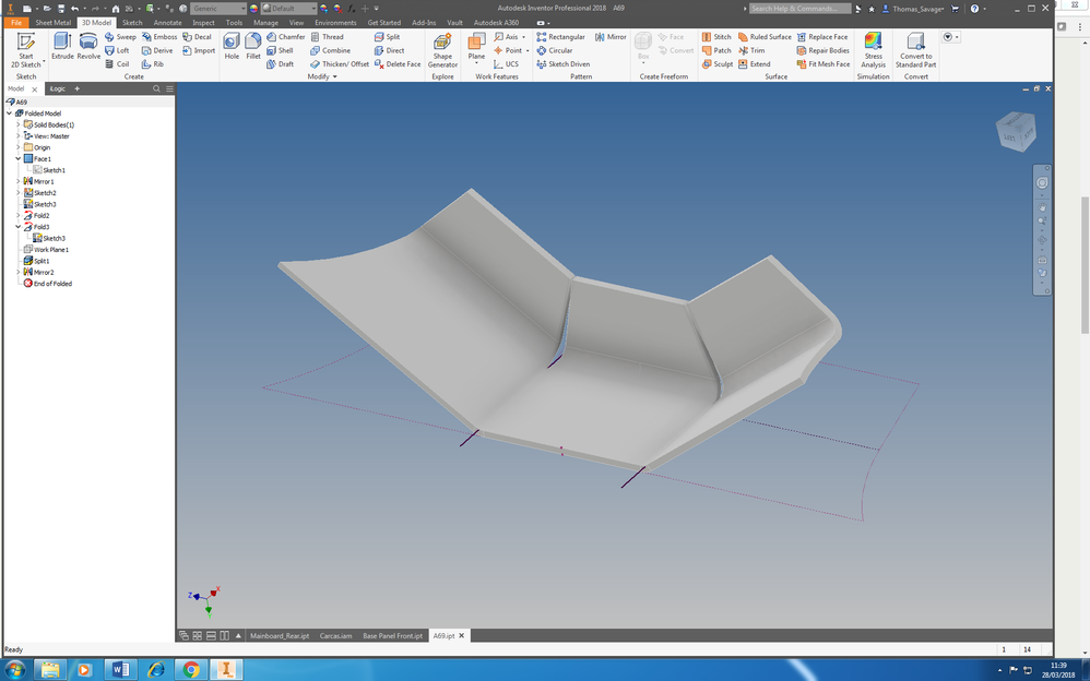

Thomas_Savage
Hello @Anonymous
Is the file and screenshot attached what you wanted?
If this is what you wanted i will create a better model for you.
I placed the fold past the Bend Radius. As this can cause issues.
You can move the fold to the correct distance. But the cut triangles need to go past the bend lines. Else it won't bend correctly.
Hope this helps?
Thomas.

Mark this is getting much closer to what I'm trying to do. I do have a few issues with your model. on fold 2, I tried to switch the direction of it so that the 1 section folds down rather than the 2 on the other side of the fold. The edit feature wont let me switch this direction, why?
Also, I wanted to repeat this fold 2 on the other side so I made another cut and tried making a fold along a cut like but it sadly wont let me select the fold line. It's really frustrating why I cant make a fold here, not sure if I'm doing something fundamentally wrong here or what when I'm making folds. See your modified part attached.
