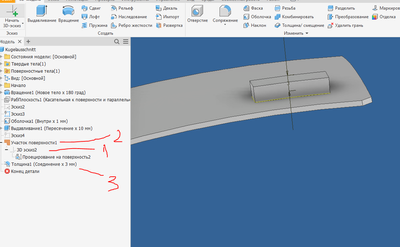

89198826955
parallel to the curved surface
1 3D sketch
2 surface area
3 thickness
